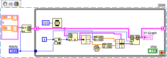

Using just one shift register is ok too:
You just have to put a little more effort into selecting the actual plot before adding new data to it...
