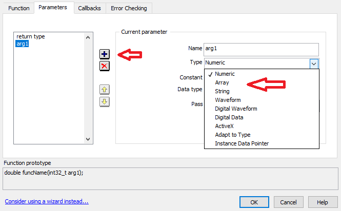

dll in labview
I would like to call to dll generated in matlab from labview.
When I use the function "call library function node", the type of the output is only scalar.
how do I change the output type, how i do array in the output?
How do I create multiple output variables?
Best regards
maya
Message 1 of 8
(4,312 Views)
The type is only scalar for the "return type". Once you add an output, "array" will be available.
Message 2 of 8
(4,285 Views)
when I add 'arg' is only more input. it isn't output...
the only output I get is in the return type.
Message 3 of 8
(4,255 Views)
This statement is incorrect. Did you read the help and documentation?
Message 4 of 8
(4,251 Views)
yes.
how I choose if arg is input or output?
Message 5 of 8
(4,243 Views)
It is both. For each arg, there is an input on the left and an output on the right.
Message 6 of 8
(4,237 Views)
can you send me a simple example?
Message 7 of 8
(4,227 Views)
There are a few very useful examples already available with LabVIEW. Choose Help -> Find Examples, then Search "DLL" or similar keywords.
Paolo
