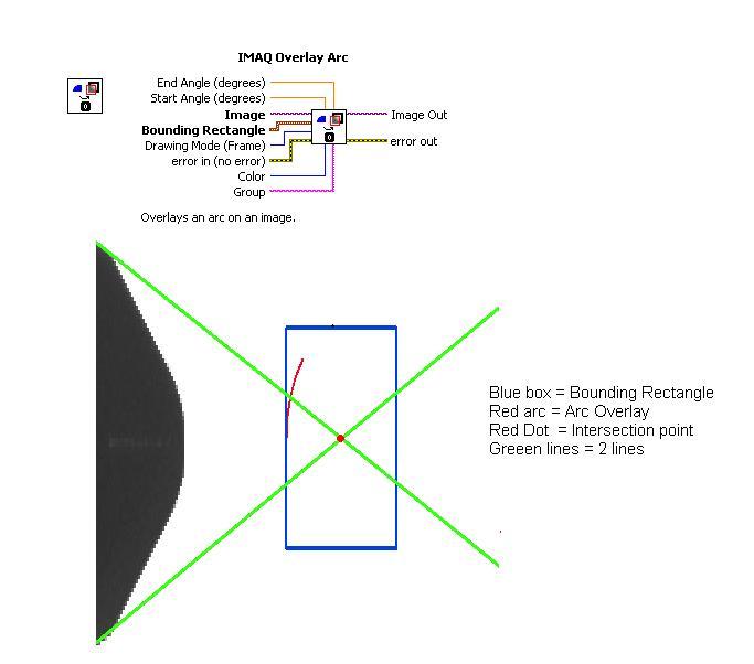

I have two lines which interesect at a point. The line coordinates and interesctionpoint is available. Now i need to draw an overlay arc between the lines to show which angle is measured. I used a IMAQ Overlay arc VI. I chose the Intersection point as midpoint for the bounding rectangle and i got was a small arc but not between the two lines.
I tried shifting the box to left and right manually but no luck. I actually want the arc to be betwwen the two lines depending on the intersection point.
Avialble infos: coordinates for Intersection point, Line coordinates for both lines (Line 1--->  Point 1, Point 2, Line 2--->Point 1, Point 2)
Anyone hv any better ideas?

I do not have the IMAQ VIs loaded on this machine (and I do not work with the vision VIs) but, as you stated, shifting the box will not help.
Check your angles on the top two terminals (start and end).  It looks like the values you are using are 110-120 (starting) to 180 (ending).
I would increase the ending angle to something closer to 250 or so.
If this does not help please post back...

Thanks for the reply. I tried with different start and end angles. But that may give a desired output for only one of the cases.  But the problem is that there are 4 different cases depending on the orientation  the edge. See attachment. At the moment i give the ZERO as start angle and the calculated angle beween the lines as start angle.

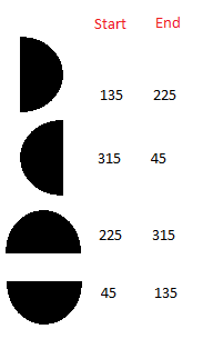

Hmm.  Sorry but I am having a difficult time understanding why only one output is satisfactory.  Could you post a picture showing an incorrect result with the starting/ ending angles provided to the acr function?
Just doing some quick math of the four different inputs I calculate the following:
Note -- these values are ideal for a circle.  Tweeking would be needed to account for the oval shaped arc resulting from a rectagular bounding rectangle

Oh OK... I think I get it now.
Begin with 0 (starting angle) and 90 (ending angle) and adjust depending on the orientation of the lines.
So before the Arc VI determine the orientation and adjust as follows: If coming from the top add 45, left add 135, bottom add 225, and right add 315.

Well I know basically how to do it but I do not have the time to code it up.  Just takes some math.  If you have the coordinates for two lines (endpoint 1 -> crossing and endpoint 2 -> crossing) then you can calculate a midpoint line (midpoint -> crossing).  Convert this line to slope and then degrees.  For an ideal circle then your inputs for the arc would be degrees - 45 (start) and degrees + 45 (end).  Again, because you have a rectangular bounding box, the arc is mis-shapen so you may have to play with those numbers to find an ideal.
