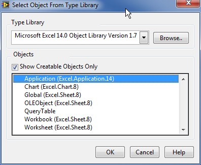

One thing you can try is to reselect the ActiveX object class. Right-click on Excel._Application control and select Select ActiveX class -> Browse ...
Using the drop down menu select the Microsoft Excel Object Library (your version may be different than the one in the following picture), check Show Creatable Objects Only and select Application and press OK. Do the same thing for the Excel._Worksheet control.
