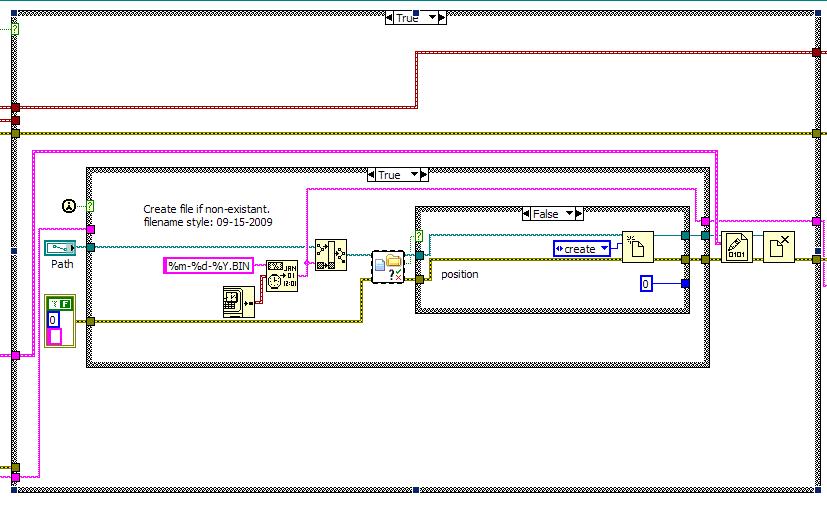

error 4 at write file +{I16} at labview 7.1
I make something like these in 8.6.1
but in Labview 7.1 I cant make it x(
could any1 upload a vi that change the name of the file and continuos writing the file for each 5 hours??

Hey Christian
Thanks for the example
but I'm having some problems here
I'm using the write [I16] file
and when the time have passed, like 5 hours
the program close the file
and when will start the other one
i receive an error:
Error1 : Occurred at Write File +[I16]: Write file
Possible reason: An input parameter is invalid
I make equal yours, i will upload the VI so if you can
take a look and see what I'm doing wrong! =/
I put the value to compare as 10 only to make the test faster.
Message 14 of 40
(1,931 Views)
You will need to change the loop tunnels of the file reference to shift registers.
