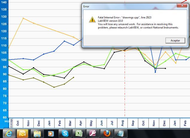

I have a program in lv10 with remote panel and all run well with winXP, but when I call the front panel from win7 and I try to change the value of any control I get a faltal internal error. Someone know why these happens.
Attached a image of message, thanks.

Hello Mahu,
This Kind of errors happend when something goes wrong internally with LabVIEW, here are two KnowledgeBase documents that might be Helpful.
The first one is about all kind of internal errors and some troubleshooting steps:
https://knowledge.ni.com/KnowledgeArticleDetails?id=kA00Z0000019UnySAE&l=en-US
This KB also explains a little bit about this kind of errors.
The second KB is about the error that your computer is showing; however, is about using executables, so I suggest to follow the instructions of the first one first and then if it is not possible to fix it with the first one use the second one.
http://digital.ni.com/public.nsf/allkb/16CF1334D094A4F6C1256BE30074B9FE?OpenDocument

Thanks, I had remove all time/date browse button of controls time. And didn't the problem again. It seems that occurs only with these controls.
(3,661 Views)
I am glad to hear so. you might be able to implement some code to use an enum control for the months and numeric controls for the day and year, then programatically convert it to a time stamp.
