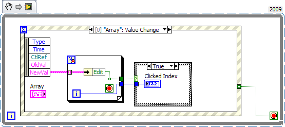

I have an array of clusters, of which inside the cluster are buttons.   I want to be able to tie an event handler to these buttons ( they would all handle the event the same, the only difference would be the index they were handling)

However, this solution did not appear to be able to deliver the index of which button in the array was pressed .. this is critical for my application.   The button is basically an "edit' buttonw which allows the user to edit the elements of the cluster through a popup.   Obviously I need to know which cluster the user intends to edit.

I'm sorry, I misunderstood what you're trying to do. I thought you had several independent clusters, I didn't realize they're all in an array. I should have read more carefully.
Personally what I would do is register for a value change event on the entire array. Then you can quickly go through the whole array looking for an element in which the Edit button is True. Alternatively you could do this by reading the array's terminal and looping through that, while registering only for events on the Edit button.

Here's a snippet showing what I described in the previous post.
