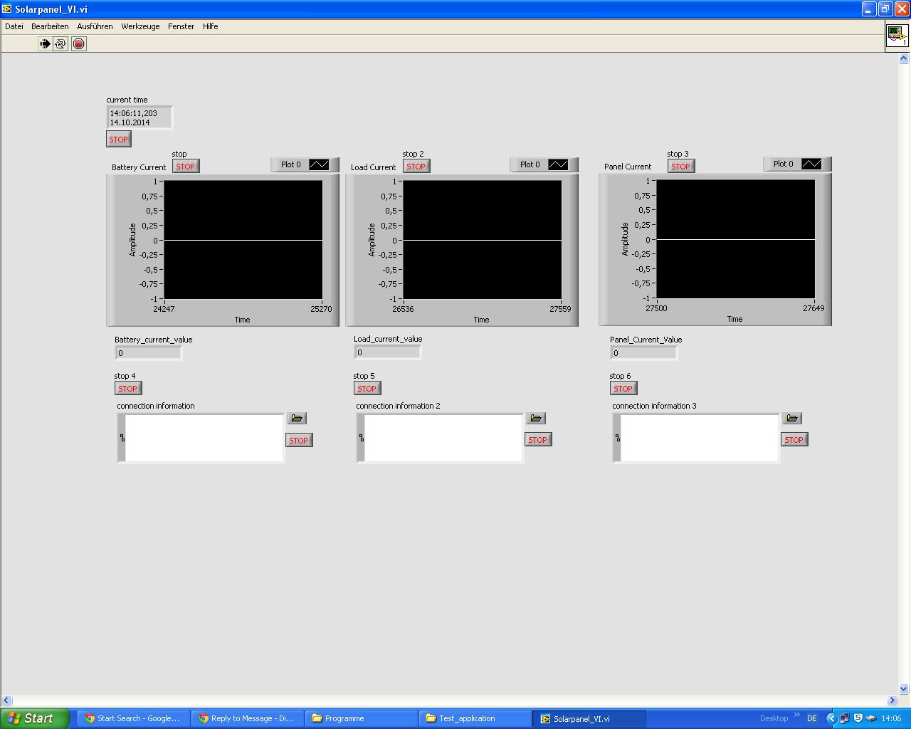

Recently i have ceated LabVIEW application from .vi to .exe file.
I tried to open this application on my computer with LabVIEW installed, it's working perfectly fine, but when i copied this file to another computer, which does not have LabVIEW installed, it didn't work properly.
By work properly, i mean the application can be opened but the data monitoring part is always showing zero, which is not true, seems like this application does not connect to the sensors at all.
Any suggestions?

there is no error, I can open the application normally but the problem is it not connect to my sensors from the platform
Message 6 of 11
(6,359 Views)
Add image little bit bigger so that we dont have to use microscop Smiley Very Happy

Smiley Embarassed
hope microscope isn't neccessary now Smiley Wink
