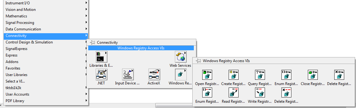

I mean writing to and reading from Windows registry using the Windows Registry Access VIs.
There are examples shipped with LabVIEW.
