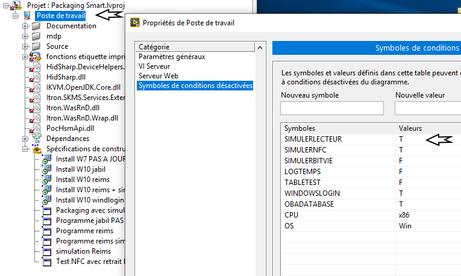

Fom Labview 2016, i'm using symbols and disabled conditions structures in order to have different contexts of execution. (like "RUN_TIME_ENGINE" but personalized) Then, I'm validating the corresponding deployed executable.
problem: when I'm creating my executables, there doesn't seem to be equivalent settings in the executable properties, for personalizing the executable.
consequently I have to manually set the variables for each one, and it's a pain in the ass.
do you have an idea to improve the deployment of .exe depending of variables?

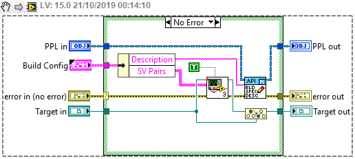

There is a "SetSymbols.vi" in <vi lib>/plugins/Utility/IfDef.llb that allows setting project Conditional Disable values with a 2D String array.
Here's an example usage (not that it really adds much, but you can at least drag the snippet perhaps)
PPL INI Parsing.lvlib_Implement Build Configuration_BD.pngPPL INI Parsing.lvlib_Implement Build Configuration_BD.png
The unimaginatively "iconned" VI is the one you want.

In fact, I'm using conditional symbols + disabled condition to simulate different contexts for execution: different company production plants, any machine, test database or normal database, no peripherals etc. for exemple PRODUCTIONPLANT = PARIS, TEST = TRUE.
then, the disabled conditional structures in my code are behaving depending of those parameters
when the executable is deployed, it automatically takes into account thoses parameters and conditional structures. that's a great point.
however, everytime I deploy one of my 6~7 executables, I need to manualy change 4~5 parameters. It's very boring, and if I forget to change one of them before the deployment of one executable, I can loose a lot of time during validation before realizing this forgetting

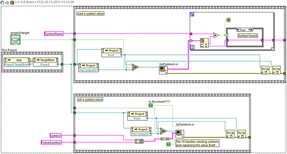

shb in the linked thread has the following image (his/her work, not mine - if you like it you should give kudos to the post on the second page here: linked post)
shb's workshb's work
You can see the way that the project reference is chosen between two different values and copy the appropriate choice in order to get the target of your definitions that you want.
