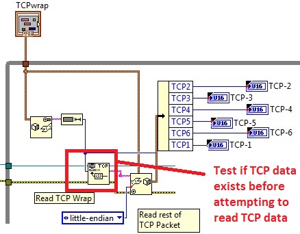

I am putting together a VI to read TCP data that has a 12 byte TCP wrap (the first 12 bytes of every TCP packet of data) but I am having problems when TCP data does not exist.
Is there a way to determine if TCP data exists for a specific device (IP address) before I attempt to read the
TCP wrap that is used for each TCP packet?

No not really - set a suitable timeout value and ignore the timeout error (code 56) if no data comes in.

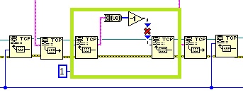

I would like to accomodate for reading the correct number of bytes and have tried unsuccessfully with the following:
Any suggestions on how best to do this?

I'm pretty sure you want to stick an array index in there as the U8 out is a numeric array and you want the Zero index.

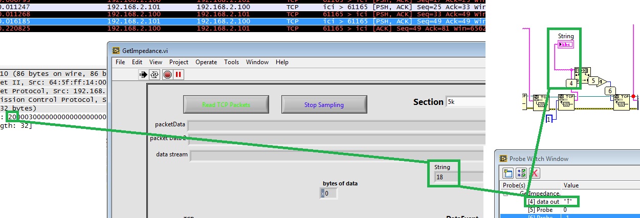

Maybe I spoke too soon...
The value that seems to change is the first byte of the TCP data which contains the size of the TCP data in bytes.
In what I am seeing, this first byte is 20h (0x20) when looking at the TCP data in wireshark, and when my front panel
displays this value as the indicator "String"  (with hexidecimal display style), it is shown as "18" and in probe watch [4} "|"
What I am trying to do is read this first byte, and then use it to read the remainder of bytes in that TCP packet but I obviously don't know what I am doing or how to do that.
Any help with this is greatly appreciated.
Message 9 of 10
(5,518 Views)
Accepted by topic author LV-rookie
0x20 is 0d32 - which is the number of bytes in your packet. If you type cast your 1-byte length string to a U8, you should get the packet size.
