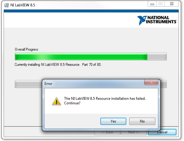

resource file installation failed
On a fresh installation of Labview 8.5, I repeatedly without fail get a "failed installation" message as follows on step 70 and step 70 only.  It says the NI LabVIEW 8.5 Resource installation has failed.  Continue?  Clicking yes or no seems to continue with the rest.  When you try to open LabVIEW after this, it says "Unable to open resource files"".
I have removed all NI components, reinstalled multiple times, and tried to repair installations as well.  I have no idea what the problem could be.  Any ideas?

The disk is clean btw.  On top of that, I tried a few different install combinations, such that the "resource file step" was a different number in the sequence....the picture shows, I think 70...with other combinations, it was 50 or something higher than 70, depending on what components were selected.  Without fail, it failed on that step, and that step only, 100% of the time.
I am going to polish the CD either way, just in case there is a micro scratch on there, but the disk in essence looks cherry.
