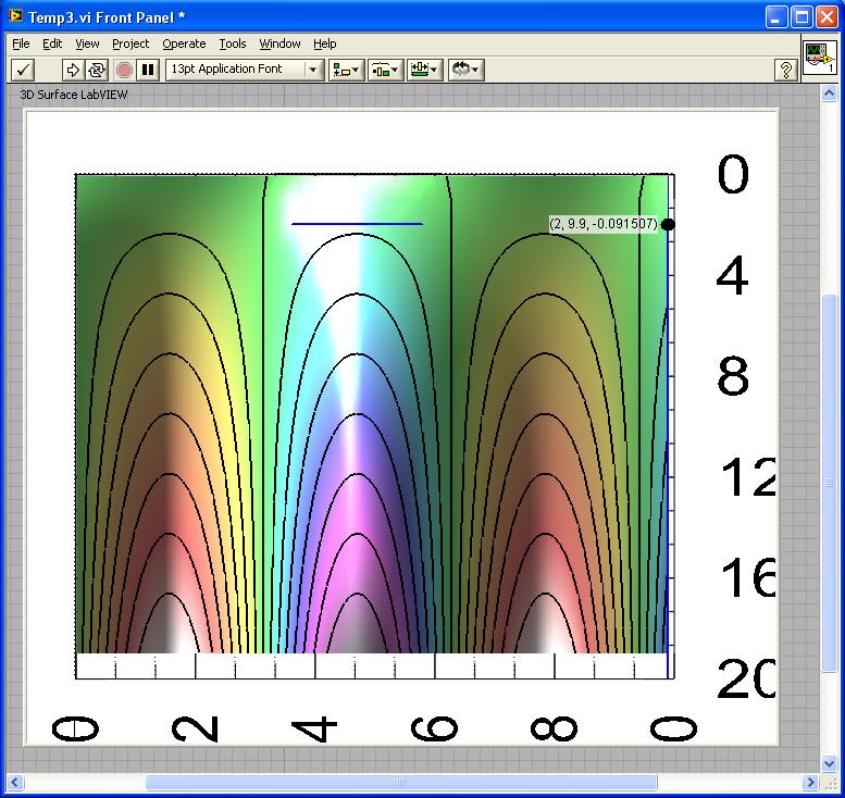

I have an array with 3 columns in it, (X,Y,Z) with a variable number of rows in it (Variable from data set to data set).  i use "3dmesh" to display this data and get a nice surface graph, all is good.  However what i would like to do next is specify say a Z index and plot all the XY values onto a 2D graph.  so if my surface was a Hemisphere (Sphere Cut in half at the horizon) i could take a value in Z and would end up with a plot of a circle.  The circles would decrease as Z increases/decreases depending which way up the hemisphere is.  Kinda like an MRI scan take slices of your head then you can flick through them to build up a picture.
Anyone know where to begin? i have looked through the math and graph pallettes but there seems to be nothing there quite suitable.

I have cut out bits of my program to make a "Mock up" of what i am trying to achieve so please excuse any wiring etiquette type things (They should be minimal).
The first vi is exactly how my data is created.  and is running ok but there are other issues here.  I run out of memory with anything above 1000 data points(N) in griddata(Not surprising).  If anyone can help me make this more efficient please feel free to give me some pointers.
The second vi is my problem that i initially posted above.  I have made an attempt and can get "slices" in one direction but not the other.  I think i will have to re-sort my data wrt Y axis or something but still a bit stumped.

Thanks for having a look at my problem  You have the right idea (You have given me the XY plane, So a slice in "Z" as i would call it i would like my data as a slice in "X" and a slice in "Y").  I have managed to get the desired effect in one dimension of my XY Graph But not the other.  If you take a look at my New VI and run it you should see the desired outcome for a slice across one direction of the 3D plot (What i have coined the X axis).  I cannot get the desired effect for viewing the data from the other direction (Y axis).  I have taken a snippet for sorting the arrays from your VI, however it still does not work, Kinda confusing.
Thanks again,  so close yet so far....
