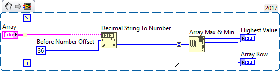

I'm making a lot of assumption in this solution. Assuming the string before the number is always the same length, and that the - is part of the number. (if its not you just need to change the offset).
But two useful nodes to look at are Array Max & Min, and Decimal String To Number. Both of those basically extract all the data without you doing any work.

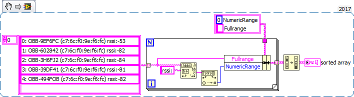

Above Snippet will hold the String Data Array of the respective numeric Value and the Last Element will hold the biggest rssi value.
Hope this helps!

Hi Palanive,
you should make that "NumericRange" element the first element in the cluster!
(Using AutoCleanup would help, too.)
(I removed the minus char from the search expression as I guess it is part of the dB value…)
