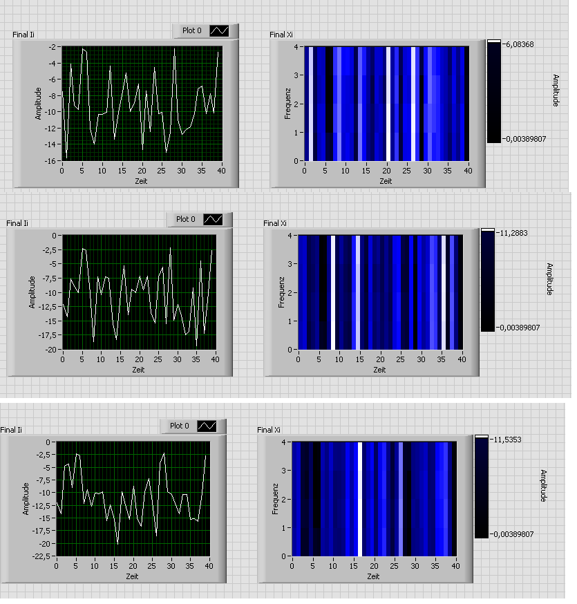

why do you think your code isn't wright?
what's the ouput you would expect supposed to look like?
You say your code is "not working" - but it does produces an ouput each time I run your vi.
Your "initial I" and "X initial" is quite randomly generated each time the .vi is started.
Let's use a fix input, to see if the algorithm generates the same output for the same input.
Ok, we get different ouputs for the same input.
Is this what you would expect?
I didn't change anything at "formula (SubVI).vi"
Message 7 of 12
