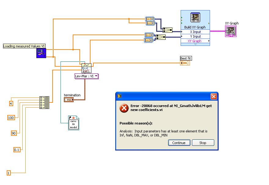

I'm using LabVIEW 8.5. I managed to represent the curve of Solar Cel standard equivalent circuit which has an equation that needed to be solved using Newton-Raphson method.
Iph - (I0 * (( exp((V + (I*Rs))/(Ut*m)))-1)) - ((V + (I*Rs))/Rp) -  I = 0
then I represent a curve of a measured values of I (Y-Axis) and V(X-axis)
but now with trying to make fitting of a measured curve with to best parameters, I'm facing many problems.
I started to make the fitting using Nonlinear Curve Fitting VI , first I tried to make the model description using a formula String , but the VI can't understand a formula with both X, Y in it.
1,Then F(x,a) as a VI.
2, where the VI solves the Formula using Newton-Raphson zero finder.
3, but then the fitting VI shows an error of input and returns the intial parameters as Best Fit ..
however it used to work well when F(x,a) was given as an ideal model equation  " Iph - ((I0/1000000) *( exp( V / (Ut*m) ) -1 ) ) "  as long as Ut initial guess is over 0.5 which isn't practical either.

I found out that the error I get from the fitting VI is due to "some" values of the Model function that are N/A which could be ignored in practical but the fitting VI couldn't ignore them .. How can I tell the model function to only send values and hide N/A values ?
Message 9 of 10
(5,451 Views)
Well, first you need to know why some values are NaN. Maybe there is a division by zero?
It really depends on the problem, but you can do whatever you want in the model, e.g. replace all NaN with a finite large number, for example.
