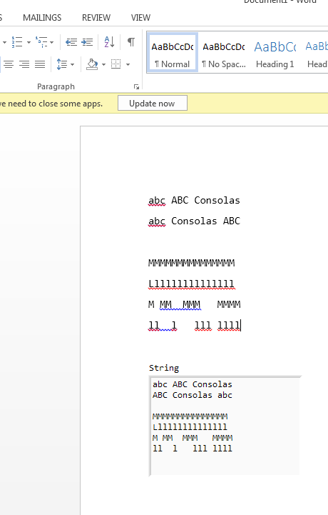

It displays for me with no problem (see picture below). It looks like you haven't change the font of the actual control.
The font ring does not display the font of the currently selected control UNLESS the text cursor is inside the control. Then it will show you the current font selection. What it does show is the default font selection if you were to drop a new control.
Put your text cursor inside your text box -- I bet the ring changes to some other font.
Select the whole control and then change the font ring to Consolas (even though it is already showing Consolas, select it again anyway). That'll set it.

@labmaster wrote:
Your font, Consolas, is not real fixed width font and cannot align some combined text (space or different width letters) with that font.
I am not sure I understand... that isn't our font... that's the Windows Consolas font. It looks the same in LabVIEW that it does in MSWord. And in both, it appears to be a fixed width font.

Hi labmaster,
we don't change the topic.
We all tell you Consolas is a monospaced font and it is displayed by LabVIEW as it should:
As it seems you're the only one having problems with this font you should check your computer and/or LabVIEW settings…
