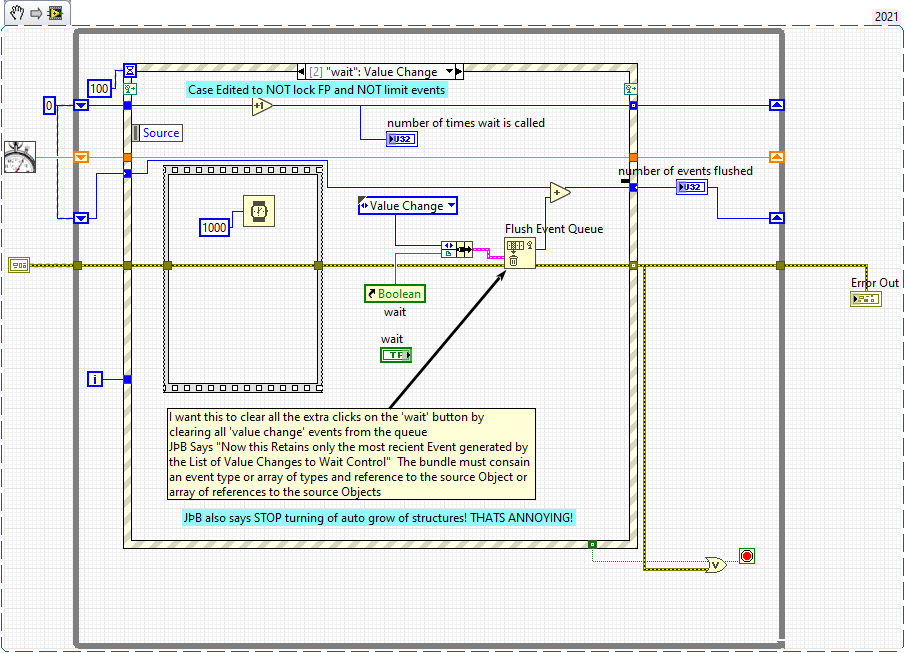

I made a demo vi that shows what I have going. My goal is to clear any value changes that happen in the 'wait' case and to display how many events were removed from the queue. This is a contrived example so there is no practical application represented here.
Perhaps someone can let me know what I need to do to get it to flush the events.

  1. Remove the Event Reg Ref wire (did you notice that it's causing an error?).
  2. Your Value Change event for the "Wait" button it set to lock the front panel until the case completes; that makes it impossible to trigger more events during the wait.

Hello Paul,
Thanks for looking. I removed the Event Reg Ref wire. I did notice the error but I was not sure how the flush event queue vi got a reference to the event case.
I made the change and updated the vi to REV B, it does not throw the error any more but it also does not flush the event queue. Even though the 'wait' case is set to lock the front panel until the case completes, events are still being queued up as you can see in the plot of timeout deltas and the newly added counter on the 'wait' case.
Does the Flush Event Queue vi need to have some reference to the event case or should it run as is in the vi?

When using Boolean controls with latching mechanical action you MUST have the terminal in code that will execute to read the value and reset the latch.  If the terminal is not read, the latch is not reset and no further value changes may occur.
When there is an event case that fires on the value change event for a latching Boolean control place the terminal INSIDE the case that handles the value change event.
Both of your latching Boolean controls (Stop and Wait) are outside the event structure and outside the while loop so the values can only be read once. Just move them into the right event cases and don't worry about trying to flail about why the events aren't firing. They aren't firing because you cannot reset the latches.  This also explains why you are confused about the flush event queue output.  Since the Boolean value change is only occurring once there is nothing to flush.

Hello Jay
Thanks for taking a look. I moved the 'wait' button inside the event structure and made the mechanical switching action 'switch when released'. I made a REV C version of the new vi. But the problem still stands.
If you click the wait button 5 times as fast as you can, it generates 5 user events and queues them up and runs them as can be seen by the 'number of times wait is called' field and can also be seen in the delay it causes between successive calls to the timeout case.
What I would like to do is after the first click in the 'wait' case clear the other 4 'wait' clicks that got queued up.
I thought I could do this using the 'Flush Event Queue' but I don't understand where to put the 'Flush Event Queue' so that it clears the event queue after the button click events are put in the queue. Right now the 'Flush Event Queue' vi is in the 'wait' case but maybe that is the wrong spot (or not configured correctly).

Accepted by Jay14159265
Modified and attached in LabVIEW 2020
A very nice use of "Bundle" rather than "Bundle by name."  Not too often you run across those.
Notes are documented in the code.
