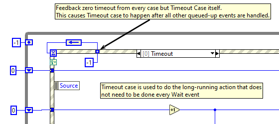

@drjdpowell wrote:
Instead of using Flush, consider this kind of structure, where one handles every Event, but only does the time-expensive operations (that don't need to be done every Event) after the Event queue is empty.  This is done using the Timeout case and a fed-back timeout that is zero.  See attached.
This method is a lot more widely useful than using Flush, as you can gather any info you want from the Events.  In the example, I gather the info about the timing of the Wait button events).
Hello drjdpowell, I like this design pattern. It provides a quick way to do event priority queueing without making your own QMH or Actors.
