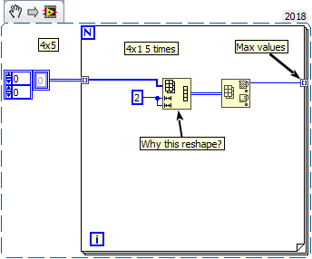

If it's just the red box you're confused about (as am I as I look at it, what are you doing?), the loop should encompass both your array manipulations. Then you remove the Index array, as if it's Autoindexed you'll get 1 row at a time inside the loop.

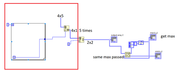

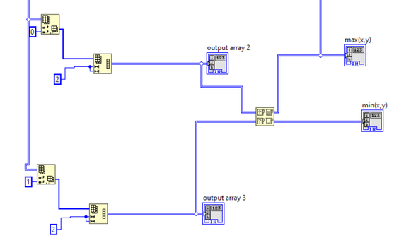

this is my main intention I have shown this without for loop and only for 0th index and 1st index, I want to do it till 4th index

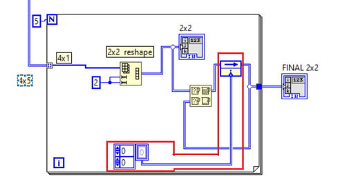

This is I tried but was not able to get an updated max matrix RED BOX

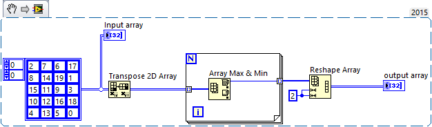

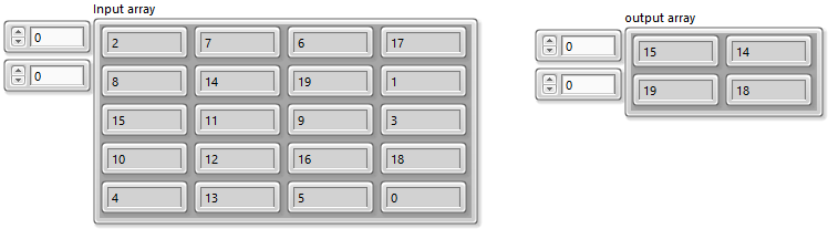

If you want to convert a 4x5 array into 5 2x2 arrays and then take the maximum value by index of those 5 arrays...
Then I would take the maximum value of each column in the 4x5 array and then reshape the 4 resulting values into a 2x2 array:
(4,302 Views)
I just gave kudos to RamonG for posting the exact same code I was about to post (so of course I like it), only quicker.  The transpose allows for auto-indexing, and there's no need to reshape until after the loop.
