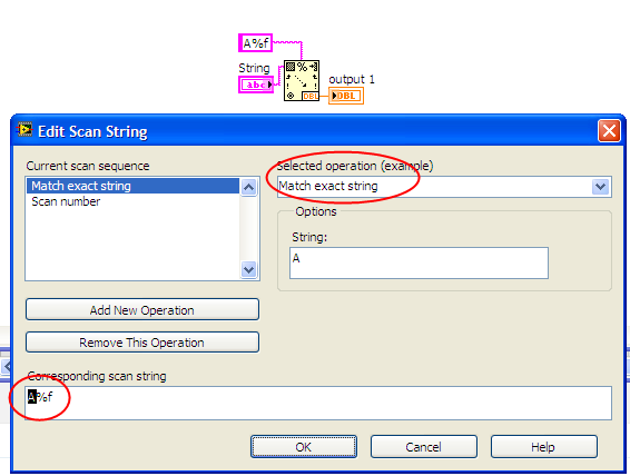

I am new to LabVIEW and this is kind of a basic question.
I am trying to understand a code and I am supposed to modify it to suite our application. So here, I've got 'Scan from String' and to its 'Format String' terminal. 'A%f'
Now I know what %f is..but I don't understand what 'A' stands for.
Thanks in advance!

It appears that your program is looking for the literal string "A" before a floating-point number.

hi jcarmody,
Thank you for such a quick response!
So in order to get say 8 digits and 3 after the decimal point, I should write '%8.3f' right?
Thanks in advance!

@netra wrote:
hi @jcarmody,
Thanks in advance!
You should probably use "%.3f".  The width is very specific.  So if you might not have exactly 8 characters in the number you will not get the right number.  Be sure to look in the help for the Format Specifier Syntax article.
