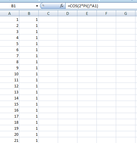

Like crossrulz said, if n is an integer, the output all always be 1:
Data Science Automation
CTA, CLA, CLED
SHAZAM!

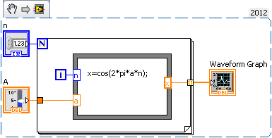

I guess the formula is ok, but you need a loop to create an array.
Here's what I had in mind:
but remember crossrulz, if A is an integer, the result will always be one.
