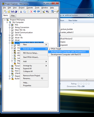

Gotcha.  So, you have FP objects for which you can manipulate the subvis, but when you attempt to change an attribute for one of the subvis, you get no response?  That is odd.  Is it possible to post the project containing the FPGA VIs?  Have you tried executing the FPGA on the desktop and debugging there?
