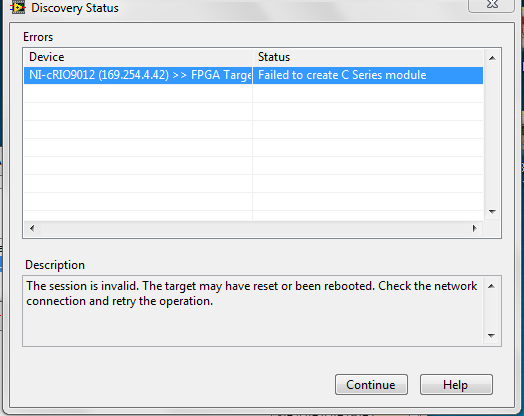

I am using cRIO 9012 and cRIO 9114 for chassis with LabVIEW 2013.
I got this error while a new FPGA project.
Can anybody tell me what should I do?

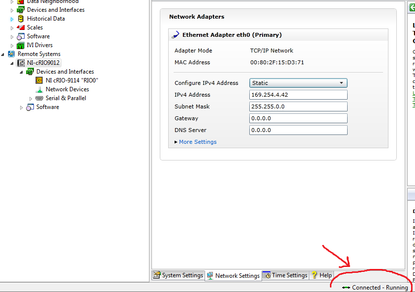

Hi PBP..
@I've tried both..give static IP @ DHCP..
i.e: cRIO 169.254.4.42 and computer 169.254.4.26..
but, still it shows this error.
I've checked in NI max, the connection is all right (connected-running)..

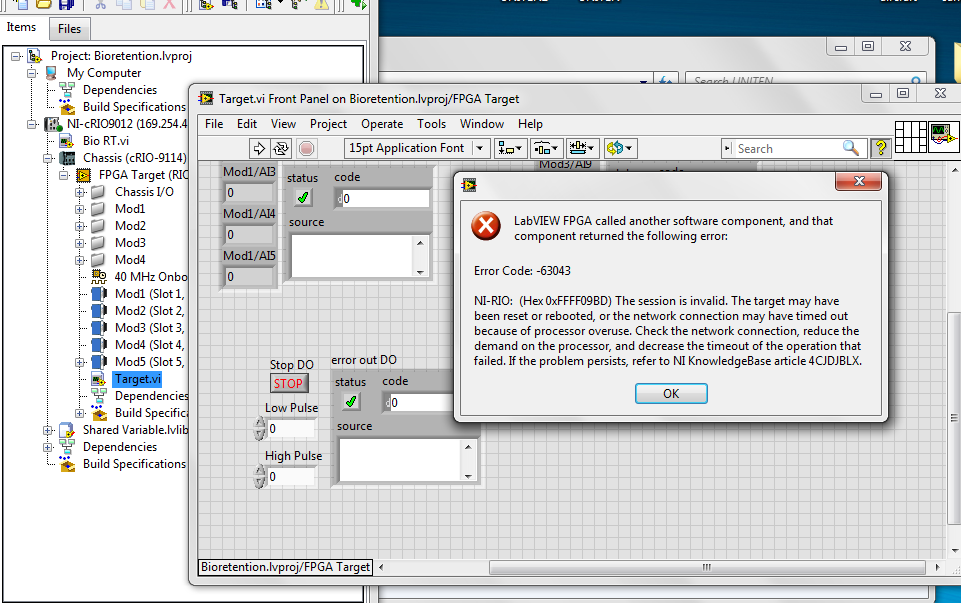

besides that, i can't run my previous fpga project anymore since it shows error-63043.

Yes, I've tried to recompile but then it shows error-63043..

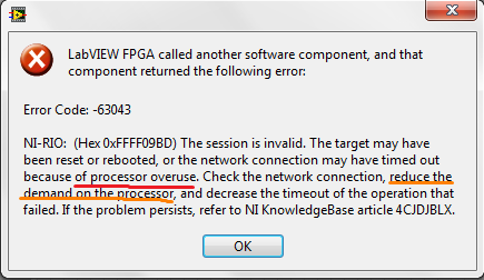

Hi PBP..
Good news! I've succesfully deployed the VI to the real time target and can build the new fpga project without an error.
I believed it caused by the processor overuse .
so, i decided to uninstall some of the unused software to the controller.
Btw, I thank you very much for your help. Really appreciate that..Smiley Very Happy
