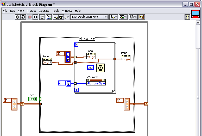

front panel shifts incorrectly
I was very bored last night so I made this etch a sketch, but the front panel shifts out of position any help would be great thanks

I don't understand the purpose of the Pane->Origin property node, but removing it seems to work.

well I am trying to give it the shaking effect when you hit the clear

Harold,
If I could just figure out how to move both knobs simultaneously, at least without moving the mouse from one to the other...
Try turning off the vertical scrollbar while running.  Because your Pane:Origin property moves the device outside the boundaries of the visible part of the pane, the scrollbars shift but do not come back.
I see, perhaps if I had one as a kid I would have known.
