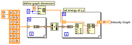

Something like this:
You can substitute the constant 2D array with your data from file. I assumed X,Y,Z(energy).
