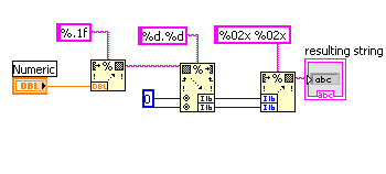

This is ONE way to split the numbers (maybe not the best). Though it works.
Then you just have to convert it to hex

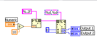

converting it to hex makes it like this, just incase

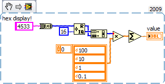

Hi Milus,
some more ideas:
Message 4 of 11

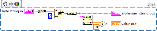

Maybe I'm wrong but I think everybody is taking the problem backward. I think the OP wants to convert an hex string (received from the instrument) to a double value.
Ben64

Bern I guess you are right.
You can simply reverse the steps from my post, I already did it for you though just incase.

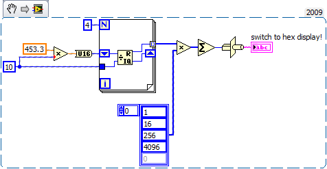

again without conversion from/to string:

Hi
The device I'm using send measured value as hex in range 0-9.
see attachment . Measured value 354,9 lm
I try proposal of GerdW and this works!!!
I checked whole range and I don't find any problem.
Thanks a lot GerdW
