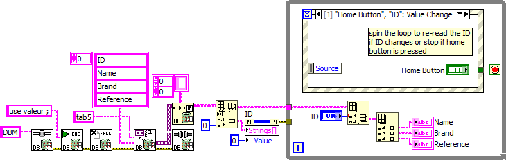

Here's what I would probably do. No need for the search button, just populate the fields whenever the ID changes. (The indexing is outside the event structure so it also updates once when the loop is entered.)

hi ,
i use the solution posted by  Knight of NI
Message 24 of 37
(1,751 Views)
Altenbach's solution won't continuously update the strings. Only once when started. This made most sense  to us, but apparently isn't what you want.
Move the code that updates the string to the time out case of the event structure (that you need to add). Also wire a reasonable time to the TO terminal...

If the database actually changes (I mentioned that long ago) your code would be highly flawed because the values in the ring and the values later read from the database would be completely unrelated. You could use my code and add a "refresh" button to re-read the database and place the 2D string array into a shift register and reset the ring items to the new database entries. You cannot necessarily rely that the current ring value corresponds to any particular database entry. What if it valid item 10 is selected and somebody would remove all but 5 items from the database??
LabVIEW is a programming language, so everything you need can be done, you just need to decide what you need.
