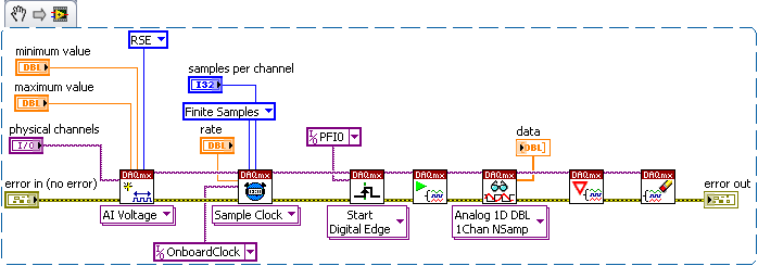

I don't see the connection between your test vi and your actual setup.  If you have equipment sending data and the trigger, your vi only needs to configure one DAQ device.  Your test vi shows and AO and some POs.  Not sure what those are.  Look at the snippet below to see how it should be done with discrete DAQmx functions instead of an express vi.  This way you can see all of the settings.  What are you using for a clock source?  It should be on-board clock.  Make sure your rate is set correctly and your number of samples is set correctly.

Okay, i think i'm going to give your vi a try, i had always used the daqassistant before so i never bothered to learn with discretes. the vi i did works, i can capture the intended data, however, my trigger is the issue. if yours works better, and i'm anticipating it may, i'll go with that. more after, thanks,

Thanks, i've copied your example, and am successfully acquiring the waveform i want for AI0, next question, how can i duplicate this for multiple channels simultaneously? can i just copy and paste the whole thing x number of times?

No, you need to put your Create Channel VI in a loop and then send in an array of physical channels.  That will set up the task to collect multiple channels.  Keep in mind that the 6259 is NOT a simultaneous sampler, it multiplexes input channels to its' one (and only) ADC.
