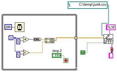

Here's a simpler way, just write out your X and Y as a 1D array each iteration. The Write will append your data as a column of X's and a column of Y's:

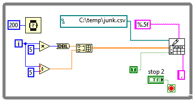

or generate all your values and then write once:
(fix the broken wire).

OH, I think I see what you are doing.  Each iteration, you are writing a 1-d array of  my precious x,y values, and then appending array after array to the spreadsheet without transposing, which means they write in rows instead of columns.  So, each data pair is its own 1-d array.  Is that correct?  Would that same way work with 3 data values, e.g. x,y,z data?  I suppose we could write as many elements as inputs we chose the BUILD ARRAY to have.
Yes, you are correct.
