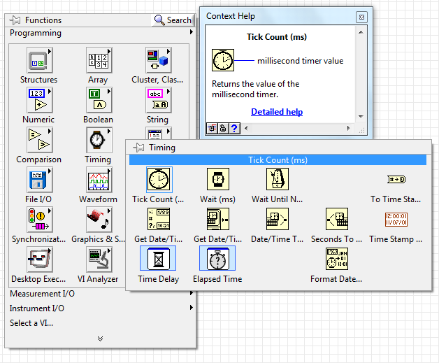

Take a look at this link:
Using the Tick Count (ms) VI to Measure Elapsed Time Over a Long Interval
And take a look at the snapshot (that's the palette you will have to use)
Best Regards
Mondoni

thank you sir for your reply, but im working on fpga target cRIO-9082 chassis it wont support those palletes , yah if i dont work on fpga target then i can use those palletes ....in attaching the vi for generating a digital pulse and acquiring it back but yrt dint got any idea hot to determine the time...if the vi is wrong please make the neccessary changes. i used this vi to determine the total time between trigger and receving signal of ultrasonic sensor.
Thank you
(2,947 Views)
Hi sachinkadde,
there are also TickCount functions for the FPGA available!
And there is this KB entry explaining how to use a 64bit tick count!
(2,940 Views)
