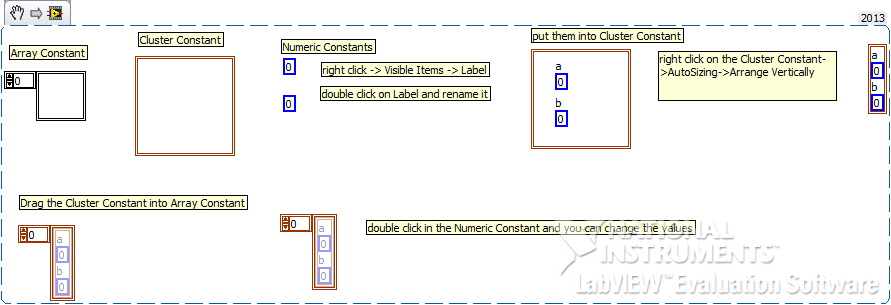

I am sorry I have a quick question. I understand this is an array constant. I can't figure out how to put the a and b values like you did here. How did you label these number constants in this array as a and b and grouped them together like this? Any help is appreciated.
Message 7 of 9
(5,621 Views)
Accepted by topic author student11
Hi, try this. Hope it helps.
Duri
Message 8 of 9
(5,608 Views)
That is perfect thank you so much.
