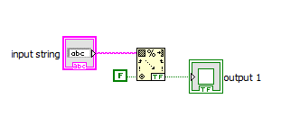

Another way.

Accepted by Chris_Cilino
Scan From String
Message 14 of 17
(4,968 Views)
Very nice tight code for string literal "TRUE/FALSE" to boolean conversion. Who would've thought of it that a Scan from String function does this instead of the Type Cast function?

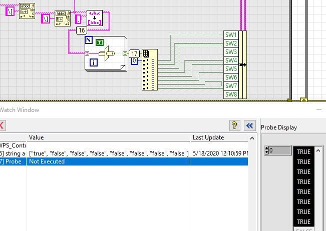

Using a Type Cast function with a Boolean constant results in all TRUE or all FALSEUsing a Type Cast function with a Boolean constant results in all TRUE or all FALSE
Using a Scan from String with a Boolean Type input results in correct conversionUsing a Scan from String with a Boolean Type input results in correct conversion
