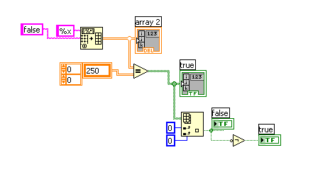

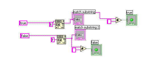

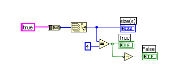

Message 6 of 17

A rudelberg one.....:smileyvery-happy:
Message 7 of 17
(25,729 Views)
Haha muks- isn't LabVIEW great; it tempts you to overcomplicate things!!
Message 8 of 17
(25,726 Views)
Absolutely............... :smileyvery-happy:
Message 9 of 17
(25,722 Views)
Lol  :smileyvery-happy:
