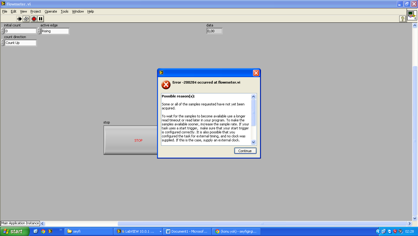

This time i run the cod in attachment and after a while this error comes;
What can be the reason?

That will not work.  Find someone who understands electronics and ask them to build a suitable signal conditioning circuit for you.
Lynn

With all of your random circuits and programming attempts, I would not be a bit surprised if you haven't already destroyed DAQ device. DISCONNECT out and do not connect until you have a functional signal conditioning setup that you verify with an oscilloscope. Then, if the code does not work, you can consider getting a new card.
