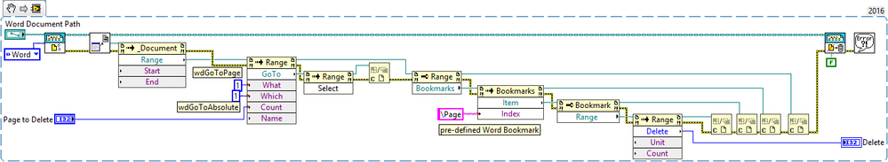

It is possible to do it but for me it doesn't make a lot of sense since you can cut a paragraph or a sentence in the middle. If you had google it you would have found answers of how it can be done in VBA. Here is a LabVIEW adaptation of what I found:
