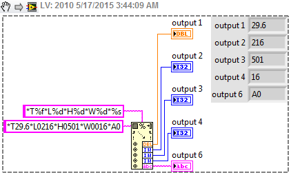

  1. Learn to make a VI Snippet or, at least, a screenshot without a camera 😄
  2. Use Scan From String wired rom the output of the VISA Read (this assumes the T, L, H, and W will always be in the response)

Did you do as I asked and create an indicator or probe the output of the VISA Read. The Scan from String should work. If you create an indicator, right click on it and enable \ Codes Display to see if there are extra characters. Post an image of the front panel with the indicator sized large enough to show the entire string.
