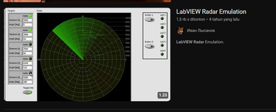

how to display such radar for ultrasonic in labview myrio

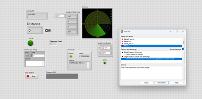

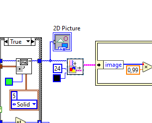

The error says that some tools are not supported on your current target. What IS the target?
