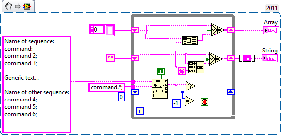

You can use regular expression to filter what you want.
Ben64
Message 2 of 19

@Atamsih wrote:
also is there an easy way to make a command that also imports a value like "command, value =4" and then read the 4?
Here's a quick pass at this request, using Match Regular Expression:
Jim
