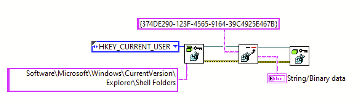

Accepted by topic author tcie
you can get it thru registry:
HKEY_CURRENT_USER\Software\Microsoft\Windows\CurrentVersion\Explorer\Shell Folders\{374DE290-123F-4565-9164-39C4925E467B}
I know, the name of the key sound funny but it can be universal but not 100%...

still it works only if the target user is configured in English, use registry key
Message 8 of 9
