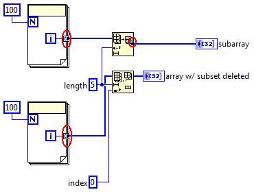

@Yamaeda wrote:
One issue is Delete from array, it often creates data copies, and you do ALOT of them, in loops! It's better to use array subset, especially if you remove stuff from the start or end.
Sorry this is not solving the original problem, but I would like to understand the above statement a bit better. The buffer allocation tool seem to suggest otherwise.
