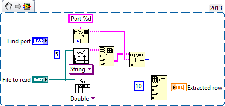

But I have to read the fifth row and then as per companys requirement I have to find ,in which column the perticular port is? and then after finding the port column number I have to do the further calculation
You mean something like this?

Yes, Exactly...
I rally this type of VI.. And I tried with this and its working perfectly right now , also seperately and also with my huge VI...
You made my day...
