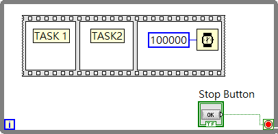

  I have a while loop to run some sequence tasks every some minutes and will stop until user press STOP button.
In this example, TASK1 and TASK2 will be executed every 100000ms. But I find that if user press STOP during the last frame (wait) it won't response to the stop and quick the application. Any way to accomplish this stop and make it of highest priority? Thanks.

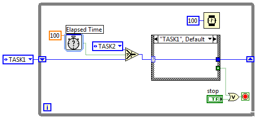

Instead of a hundred second frame, make it a while loop.  Have the while loop run at about once per second and only stop when the Elapsed Time Express VI reaches 100 seconds OR the stop button (now placed inside of that while loop) stops.
The stop button will also wire out of the inner loop to stop the outer while loop.
Another possibility is to use an event structure in that frame with a 100 second timeout case, and a case for the Stop button's Value Change event.

use a simple state machine....sequence of events are TASK1>TASK2>EXIT. your software timing should be ALWAYS done with timers and not the "wait ms" loop iteration as the front panel can only responds as quickly as it is set.
I'd actually make it a FOR loop with the conditional terminal turned on.  Set N to 100 and wire the stop button the the conditional terminal.
Honestly, I think the best solution is to use a state machine.  In the state machine you have Task1, Task2, Idle (used to check for the button presses), and Check Timeout.  In the Check Timeout you can use the Elapsed Time function to see if your have reached your 100 seconds and proceed as necessary.
