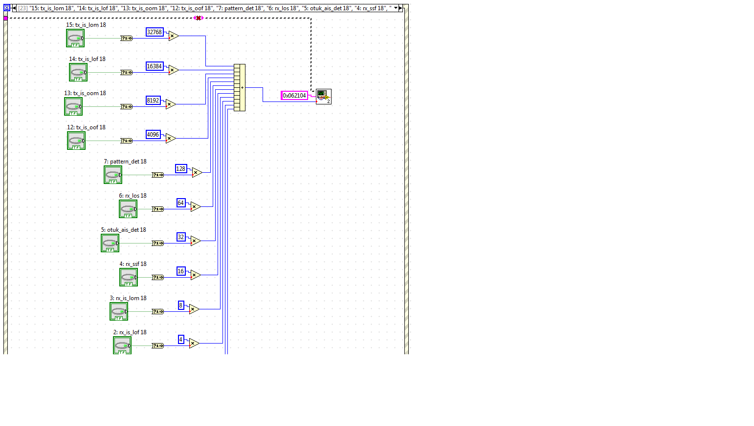

Yes, there are probably a couple thousand different controls the user could click on.  They are sorted across probably 40 tabs that follow a nested structure.  Each register has up to 16 bits, and the user can control the value of each bit.  So an event structure for a given 16 bit register might have as it's first case, bit0, bit1, bit2...bit15: Value Change so that that event structure code executes if any of those bits change.

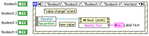

Hi bmishoe,
using Ctrl references is quite easy:
One event for different boolean controls. You can distinguish them by their label…

hmmm...I must be missing something...how is that different than what I'm doing?
Message 9 of 20
(5,594 Views)
You are doing something in combination with all controls if any given one of them change.  That is just fine if that is what you need to do.
What Gerd shows is how to do something with a specific control when that control changes.  And that one event case is handling 4 different controls.  The alternative to this is having 4 different cases, 1 registered to each control, and each case only being able to handle that one specific control.  You wind up having nearly 4 times the code doing essentially the same thing.
In your image, it looks like all of your booleans are related.  I would put them all in a cluster.  Then you can have the event case registered for the value change of the cluster rather than registered for each and every control that is related.
Now if you have a second cluster that needs to be handled in the same manner, you can do what Gerd shows.  Have the event case registered for the value change of the two clusters (rather than 2 times the number of controls that you currently have).  Then use the Control Ref to determine which control fired the event, use the New Value node to get the values and send them to the subVI.
Actually I see the relationship between your  booleans is just for binary values.  Instead of having all the math, true/false to 1:0 conversions, and the addition, your control should be a boolean array.  Then you can use the boolean array to number function to get the numeric value directly.  Then you'd have  basically 1/16th the code you already have.
