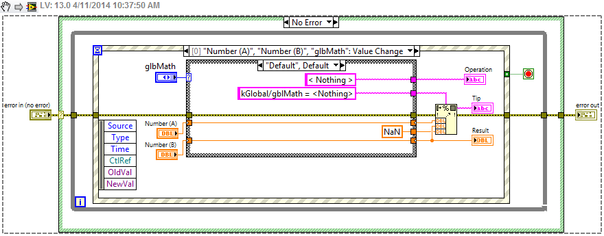

Well fisrt off kGlobal.vi can't run.  It is a global variable there is no code to run
Your code has some problems and should be re-thought out.  Use an event structure to respond to user inputs.  This way you won't burn up the entire CPU re-calculating the same result as often as possible.  Seriously, you only need to calculate and update the display when A, B or the operation changes.
What you have is a first-class case of localitis and global abuse.  Not to mention that you forgot the programmer's mantra "Code it once!"
A quick revision uses no locals, no globals and no greedy loops
and attached back saved to 8.6 per vi properties

Well if you MUST, (And I discourage you from abusing a global like that its not what they are designed for)
The FP.Open method works well on Globals Set "Activate="TRUE" to put key focus on the global (even in 8.6 I had to double check that the method would save back that far)

A static VI reference constant is available in the functions palettes Programing>Application control. Drop it on your BD.  Rightclick and browse for the global or drag the globals icon into the reference.
I assume you tried creating a constant from the invoke node.  That will create a strict static reference and you won't be able to drop a global into that.
