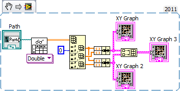

Hi hussey,
don't use ExpressVIs for such a simple task:
Message 9 of 15
(5,084 Views)
Accepted by topic author hussey
I guess the first coloumn in the excel sheet is your x values?
Message 10 of 15
