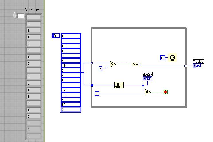

Something like this?
(2,996 Views)
Hi muks,
  it may be or maynot as it depends on the sampling rate at which you sampled the eeg signals.
