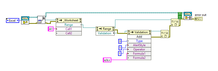

hi,
you find below solution for your topic :
Best Regards .
Kudos are welcome .

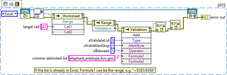

This might be useful if you're trying to use a data validation list.  A description of the parameters for the Validation.Add method can be found on the Microsoft web site.

@PsyenceFact  已写:
