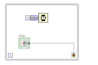

Words like "before" and "after" are very dangerous when applied to a dataflow program. Unless there is a data depedency, reading the stop button can happen at any time during the execution of the while loop. If it is just a stop button wired directly, it probably will get read very early into the current iteration.
Have a look at the following code (shown during execution highlighting). As you can see by the green data dot on the stop terminal, the button has already been read, while the wait is still waiting. For an even better demonstration, run the same code normally and press the stop button after about 1 second. The button will reset back to false (latch action) after 9 seconds at the beginning of the second iteration, at which time it will take another 10 seconds for the program to finish. The total execution time will be 20 seconds unless you press the button before program start or within the first nanosecond or so. 😄
Message Edited by altenbach on 04-24-2008 10:52 AM
Message 9 of 17
