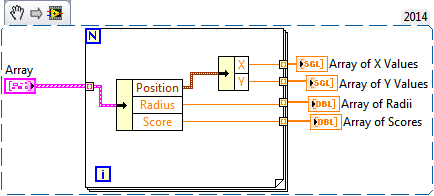

The IMAQ Detect Circle vi returns an array of clusters. Each cluster contains a position cluster with X and Y information (single precision float), the radius (double precision float), and the score (double precision float). You can separate these out by first getting a single element from the array. In the snippet below, I use an indexed tunnel in a For Loop to do this. Then use the Unbundle by Name function to separate the three elements of the cluster. You'll need to use the Unbundle by Name function again to pull out X and Y from the Position Cluster. Then just run all values out of the For Loop with an indexed tunnel and you have it. Hope this was what you were looking for.

Actually, the second unbundle by name is not needed. Clusters within clusters can be unbundled directly.

Thank you both for your helps. I did it like you explained.
